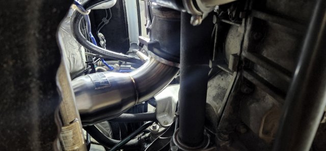

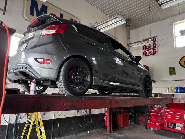

Today i had a catless DP installed and wow, im so glad i did. $145 install and i LOVE it. It is louder as people mention, and more so with certain exhausts (i have an MBRP), but you can also hear a the turbo spool now, although faintly compared to the loud exhaust note. Boost also seems to build faster now due to freeer airflow so it's more responsive. Lastly, unless it's min imagination, there seems to be a bit more decompression when letting off the gas which i dont mind. Ok one more thing, the sound is freaking amazing, far less smooth muffled sound, it's got a sharp raspy edge to that low rumble. Sounds like a legit rally car now (along with other mods).

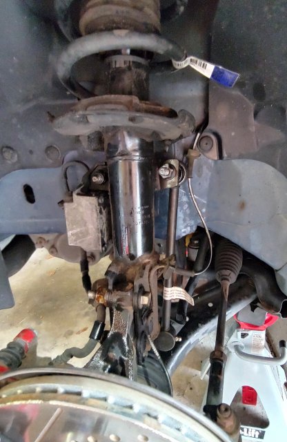

Replaced the sway bar links after TyphoonFiST suggested I inspect them. They were very loose and the bottom ball joint did not budge at all. Easy to do, just time consuming as you have to hold the allen nut so it doesn't spin. Installing them required an 18mm wrench ( to prevent the nut from also spinning) which I do NOT have in my collection. I was somewhat alarmed that the boot for both struts had wiggled free but I was running late and sweating like a pig in the humidity. What is the trick to get the boots back on?
My next purchase will be the Whoosh 2 point Trac Bar, unless there is a better option in the same price range.

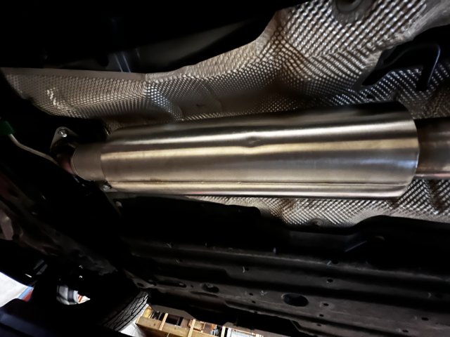

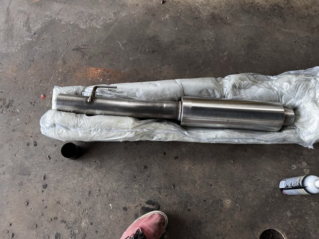

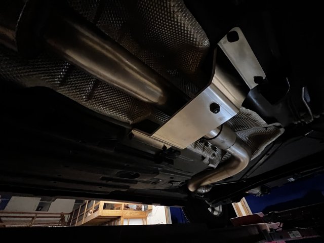

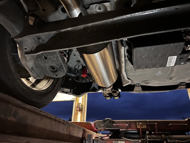

Haha kinda funny I just went to catted today. My idle dB's we're 82 with window down in driver's seat. With high flow cat she's down to 74. The high flow cat still has the turbine sound, it's just quieter overall but still 4-5dB louder than stock down pipe. This car seems to stink more than my old Galant when noncatted. Running e30 was making my eyes water. 20220810_191752.jpg

Interesting. Mine registered 66db on cold start (driver window down) and 57db once idle dropped and I have an MBRP catback which are thought to be loud. What exhaust setup do you have?
I have the 2j racing side exit. I think its just the location being that much closer to the window making the car loud inside. That was with all my windows down. My measurements were also used with a phone app. I wouldn't call it the best measurement device, but it does give people an idea of the difference.
ok gotcha. FWIW i looked up apps and the National Institute for Occupational Safety (NIOSH) cleared 4 phone apps as suitable for db measurment, the one i got is called NoiSee, it was a dollar.I also had only my drivers windown down so that could have quited it too. Either way yea, the catless made it much louder 🤣

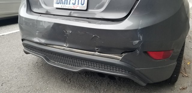

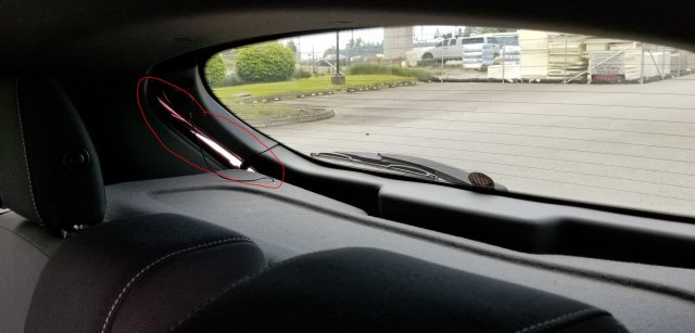

So I got rear ended on the freeway back on June 20th. It messed up the bumper cover and bent the hatch. You can see the circled area in the 2nd pic where you should not be able to see daylight. All the body shops around here are way backed up so it didn't go in until last Monday August 1st. This was 100% the other guy's fault so I have a rental car from his insurance which good to have but it is a Nissan Versa. 1.6l normally aspirated with a CVT and slow AF!. They say they will have it a couple more weeks and I'm loosing my s4it. I need it back, this turdsa is killing me! How do people live with slow ass cars on a regular basis? Who buys this s4it? Life is too short to drive boring, slow a55 cars.
