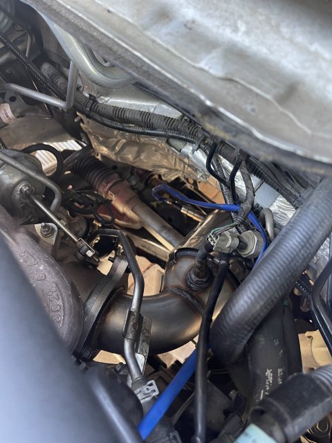

Did you use a defouler with it? If not any codes? I have one going in eventually. Curious what to expect also using Thermal exhaust
No defouler. Has not triggered a CEL yet. I was running a whoosh catted for 6 months before I had to take it off for smog, ran it with a dizzy stage 2 and never got a CEL.. now when I flashed my e30 dizzy it did trigger a CEL, once I went back to stage 2 no cel

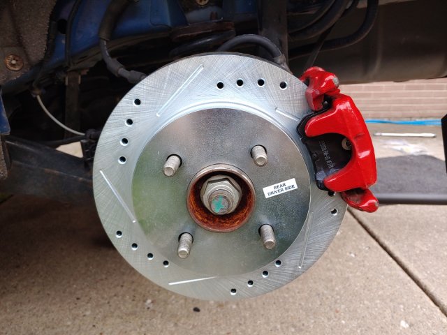

Did the back brakes which were more difficult than the front. Both sets of slider pins were rusted in place, even the ones that had the boot on correctly. One side was so bad, I had to use 1000 grit sandpaper to get the finish smooth again. Luckily I had some pin grease left over as the back s didn't come with any like they did with the front set.

I struggled to get the inside pad pin aligned in the piston X grooves. I still feel like the brakes are less grabby than before I swapped.

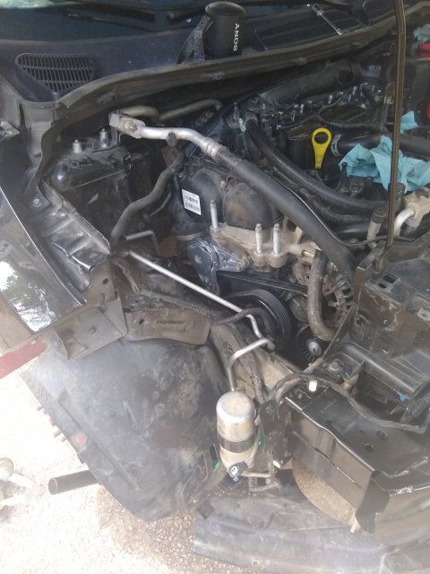

Installed my ac line that I always complain about. Now I just have to hope and pray that my compressor is not shot.
The line required some bending to get it to fit, but it shouldn't be rubbing on anything.

Had to bend mine also. It was the bottom hose on the evaporator to the condenser. Also I have everything ro pull the vacuum and refill. If you want to make the hour drive.

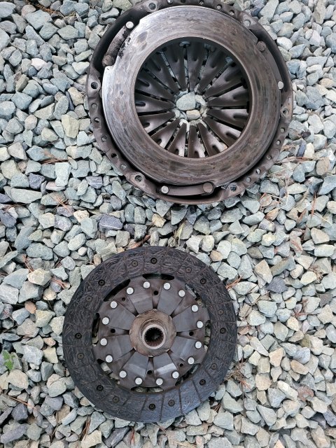

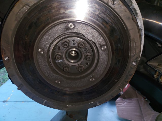

Dropped the tranny in the s280 fiesta. Looks like my tranny took a dump, i was thinking the noise was the flywheel. Thankfully I had already order a new to me one along with the rts kit. Here are some pics of the flywheel and clutch. If anyone needs a core or transmission to rebuild just lmk. 20220613_203123.jpg 20220613_203137.jpg
I have a buddy who works at a shop, but if he's slammed, I might have to take you up on that offer

Dropped the tranny in the s280 fiesta. Looks like my tranny took a dump, i was thinking the noise was the flywheel. Thankfully I had already order a new to me one along with the rts kit. Here are some pics of the flywheel and clutch. If anyone needs a core or transmission to rebuild just lmk. View attachment 49246 View attachment 49247
I'm curious what failed in the transmission. Are you going to pull it apart yourself?
Contact Colby @ Clarke Transmissions. He may be interested in the core*
I did at first, but you can see the top grove very easily. Once that is vertical, you'll know the bottom will line up with the pin.
