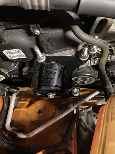

Installed Damond Motorsports passenger side engine mount, now its time to see how it is. I like the design thought the excution could have been better . i.e. a bit heavy and sloppy welds . Though they are done strong enough just really sloppy. I figured I bought it throw it in and see how it is . I can always change it out to another brand if I want 8DC6C28A-F23A-4BA2-B8D8-F9A18EC1973C.jpeg B247F318-75A0-4DBB-AF0F-03DD6F94A251.jpeg

Installed Damond Motorsports passenger side engine mount, now its time to see how it is. I like the design thought the excution could have been better . i.e. a bit heavy and sloppy welds . Though they are done strong enough just really sloppy. I figured I bought it through it in and see how it is . I can always change it out to another brand if I want View attachment 41810 View attachment 41811
The only Negative is No third mounting point like with the Vibratechnic...TTR etc.. let us know the vibes with the A/C on also!
vibe with AC not too much different than Vibe without definitely getting a little vibe with it at idle like it transmits through my seats but its not horrible and its a quite vibe lol . otherwise torque steer is all but gone. Of course I am about to flash my e30 tune so I am just doing a drive around for a few miles to mix the gas up in the tank.
