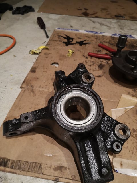

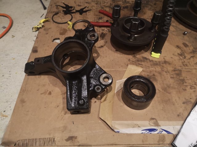

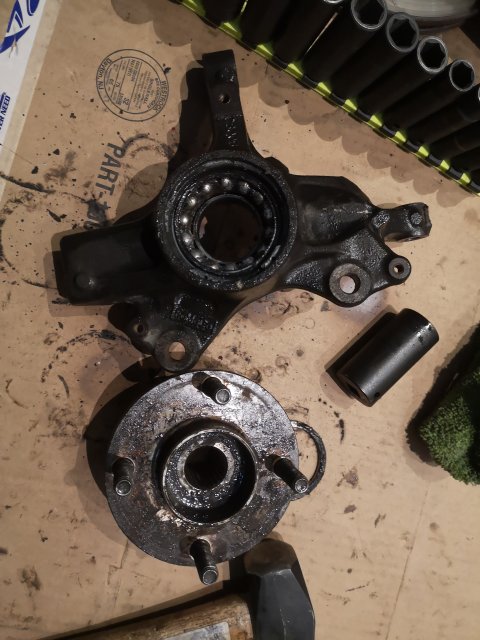

Did my front right wheel bearing. I think I'm on the right track. I suspected wheel bearing but there wasn't any play when I do the wheel shake method, but after I took the knuckle/hub assembly out, there was definitely play between the hub and the knuckle. Taking the old bearing out was the hardest part. Took me the better part of yesterday just to do that since I did it at home without a press. This probably a job I'd pay someone to do next time lol. Soaked the whole knuckle with old bearing in a bucket of transmission fluid for a few hours and it came out but took just a tiny bit of muscle lol. Going to reassemble everything today.
