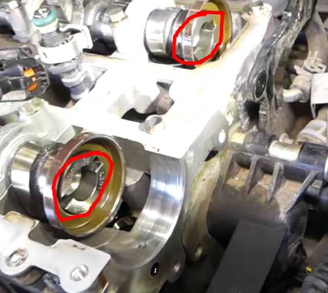

finally started to tackle my p0017 code, Crankshaft Position - Camshaft Position Correlation (exhaust)
I have previously checked the most common stuff before like sensors and, cables, solenoid, etc with no success
My suspicion is that it jumped a tooth on the exhaust cam
to really check if it jumped a tooth and to put it on time I have to take the valve cover off, so that is what I did first
for those that don't know, to take the valve cover off, you have to take off the fuel rail, HPFP, vacuum pump, spark plug coils, spark plug coil support, and all the cables that are around that area
After I removed all that, I checked the end of the camshafts to check if it was on time
I don't really need the timing tools yet, I just have to physically check if the camshaft was aligned to one another to check if it was on time or not.
to check, both "line-like aperture" on the end of the camshaft has to align with one another. As mas suspicion was inclining, it was out of time, the exhaust cam was a slightly out of sync with the intake
the picture is for reference, not my car

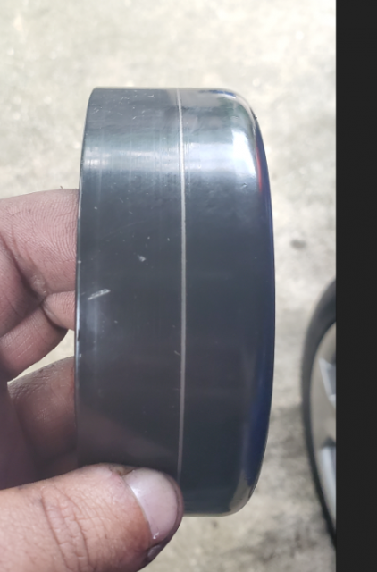

^^^How many miles on it when that serpentine belt decided to give up the ghost?
60k give or take
one thing that was curious was that the water pump pulley cover, whatever its called, has a really bad gash-like groove line
I guess my theory is that a piece of rock got between the belt and that pulley cover and cut the belt thru the middle
other than that, I don't know
I installed a new pulley cover

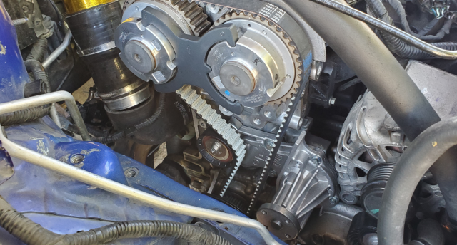

I did start tearing apart the side to access the belt
when I took the belt cover off, I saw some belt like string around the area, and the tensioner
The timing belt looks intact, so the only thing that comes to mind was the serpentine belt that broke in half last year
I don't know-how part of that belt came inside the timing belt area because that area is sealed but it did
my theory is that, part of that broken belt came between the tensioner and the timing belt and made the belt slip
i will be finishing today, since i didn't have time yesterday

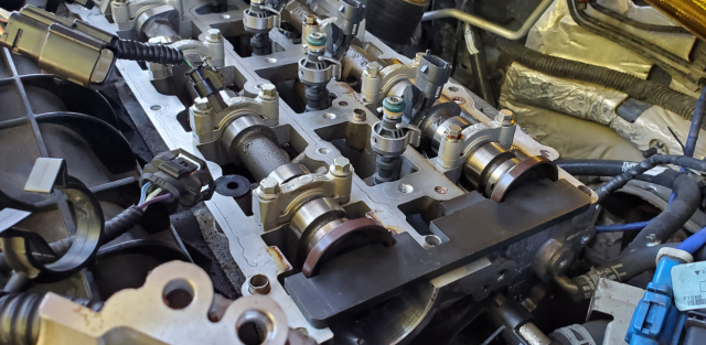

For anyone wondering how it went, car is running great, 0 leaks and 0 cel after running the car for 2 days
did an oil change today, new spark plugs and used the new yellow coolant when i installed the water pump, now the car is just running like new
just thinking back in retrospect, doing a timing belt/tensioner/water pump change is not that hard
but since i had to remove the valve cover to timed the camshafts, the job escalated too quickly.
it took me more time to get the valve cover and the stuff that is in the way to time the camshaft than to reach the timing belt
here some photos that i took, not really a lot
the culprit
