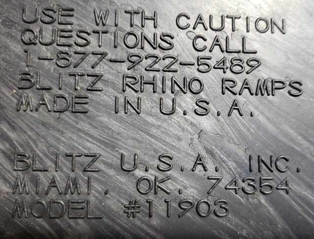

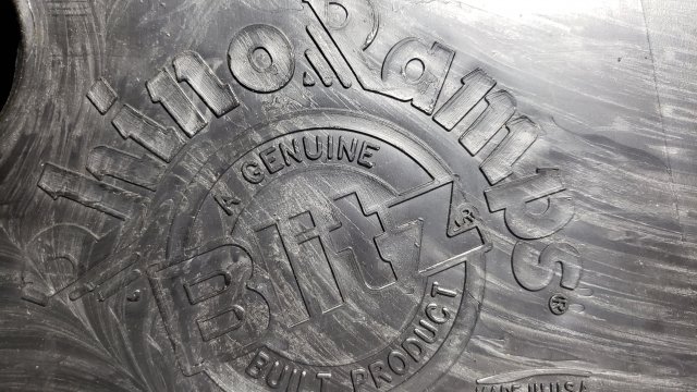

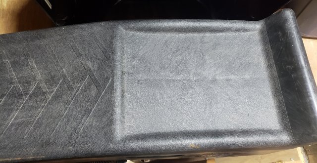

Buddy where did you buy those car ramps (are those rhynos?)
Thrift store like the rest of my life. Yoga mats, jackets, shirts, the list goes on. Idk what brand off-hand, but that or the other popular brand. Low profile and bumper JUST clears... I can snap a pic if you want. They're up in the garage attic.

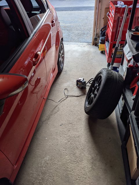

For real. Now that I have the ramps changing oil on the old daily now. The drain plug was on WAY too tight from the place that did it last.

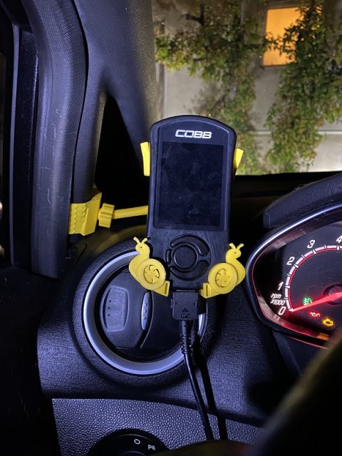

^^^HA, I never realized that Sir Thomas put those little boosted slimers on his AP holders! NICE touch! [coolsmile] [thumb]
I actually got this off of Etsy from a guy that i think is a FoST owner. 3Dautomotive is the name in case anyone is interested.
The grille detail on the pillar mount caught my attention and theres also a big ST logo on the other side of it./
The holder is also magnetic to the AP
