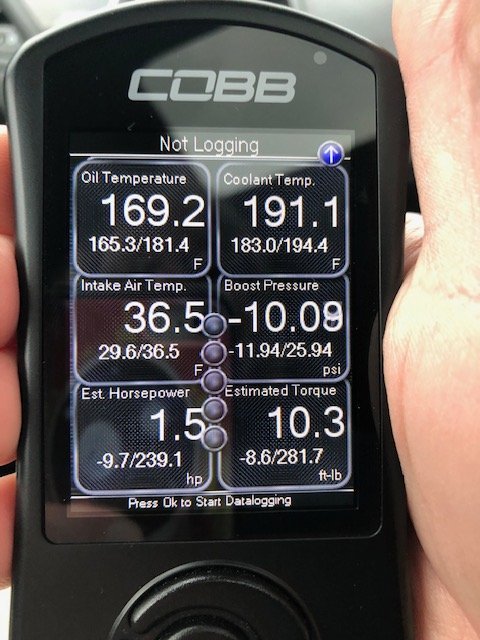

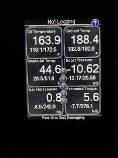

The ECU is still learning. Cracked 240 hp! This thing loves the cold intake temps. I'm curious to see what the difference will be when it gets hot out.

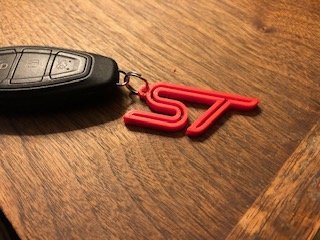

Also received my pillar mount from Razzter. Works great, very nicely made, and he threw in this nifty little key fob, too. I like it. Would recommend.

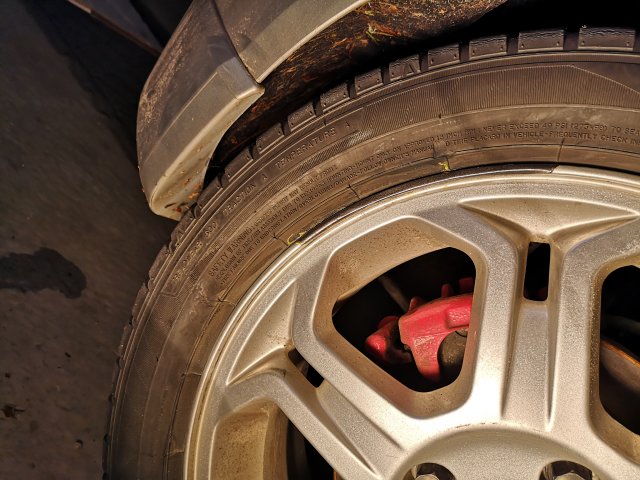

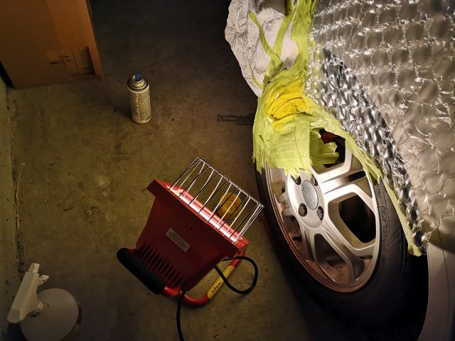

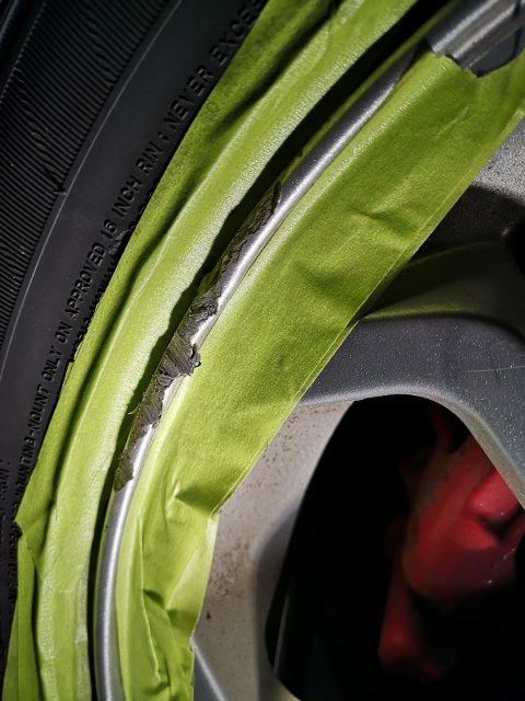

Did a ghetto curb rash repair this morning. I'm not trying to make it look perfect, just decent. The lip was actually bent, had to bang it out with a punch, then I just grinded it smooth. Sprayed some zinc chromate primer, then some high build primer. Gonna run out and grab a close matching silver. I don't think I'm even going to clear it.

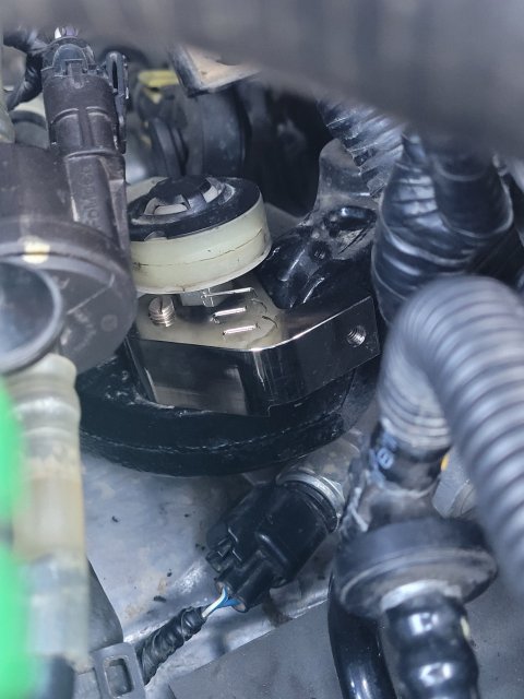

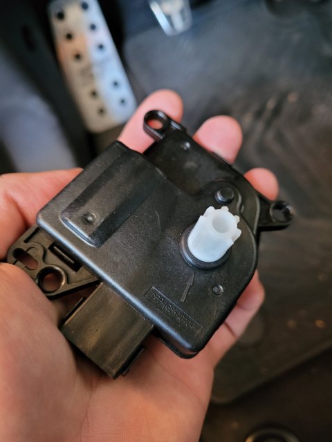

Installed the Mountune Quick Shift yesterday. The FiST is even more fun to drive now .. didn't think that was possible. Got some Ravenol MTF-2 on order so hoping it will make shifting that much better.

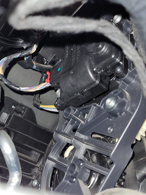

Also replaced the driver's side blend door actuator. Just have to change the passenger side and no more clicking!
