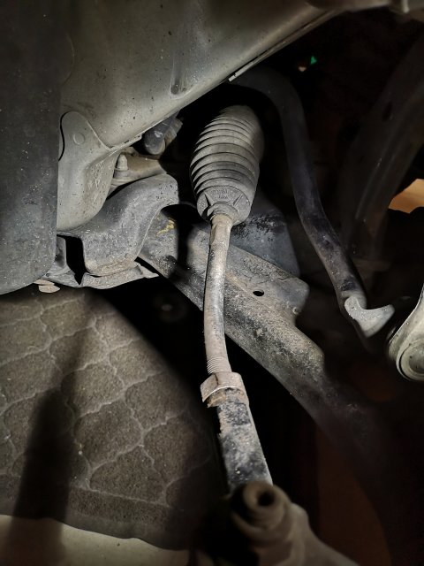

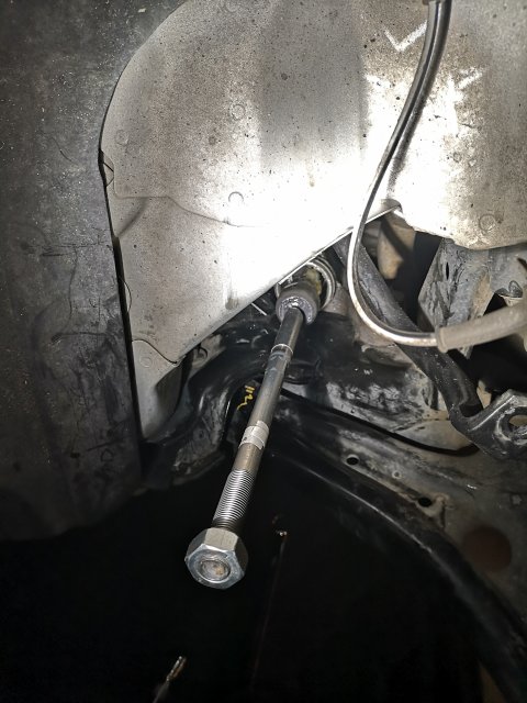

I was driving my car pretty hard and tried to Tokyo drift around a corner and smashed into the curb pretty hard. I forget I'm on crappy all seasons for winters right now. My tie rod got bent and my wheels got curbed up pretty badly. Luckily no body damage. I replaced the tie rod and I need to go get an alignment now.

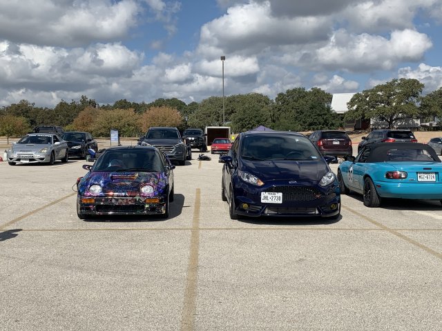

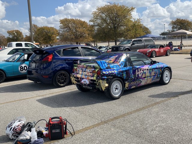

Over the past couple days I installed Centric rotors, OEM pads, bled the fluid, rotated my tires and cleaned her up in preparation for Autocross today. Got 1st in tire class and realized how big our cars are compared to 90's cars. Car is an Autozam AZ-1 for those that don't know, super rad. I really need to pull the trigger on some tires soon. I'm at 3/32nds on my RS-Pro's

I really like those AZ-1s. A few months ago, I considered picking one up, I didn't realize how tiny they are! Makes our FiSTs seem like SUVs.

Is that thing street registered and legal??
Yeah, I always laugh when people claim that our cars are sooo 'tiny'.
Maybe, as compared to the 'usual' road tank SUVs and trucks on the streets today, but that above is what I would call a micro-car, as is a Smart car, and a few others. [wink]

Yep! Street legal, registered, RHD from Japland. Would love a Kei car like the Autozam, Cappuccino or even the Suzuki Carry's just to put around town. I wouldn't have enough guts to put in on Texas highways lol

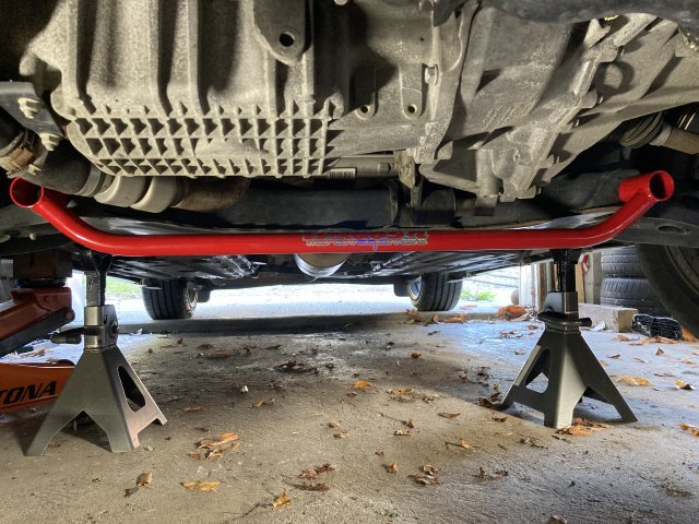

Installed the Woosh Trac bar finally. Gouged it on my driveway first time backing out. View attachment 35959

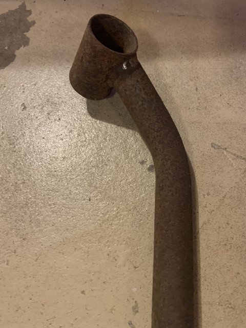

Looks good in red! I just took my whoosh bar off yesterday. One year on the car and it completely rusted. Idk if because it's so low or poor paint / powder coat. I'm going with tb performance 4 point.

That is terrible how is the rest of your car when it comes to rust?

Car is fine, not bad at all. I have a whiteline rear sway bar that's been on for a couple years and still looks new. The whoosh sticker looks cool though with the rust, it has become art.

that appears to be the lowest cost option of "matte black paint" which we no longer offer. It's a light coating of black spray paint applied at the factory. Most customers were opting for the $80 bar with no powder coating instead of paying the upcharge for powder coating which is much more durable than spray paint.
The only available options currently are powder coated gloss red, wrinkle black, and cosmic white

I had to check my email from when i purchased and you are correct, it was matte black paint. Somehow i missed that at the time of purchase, i assumed it was powder coated. Glad it isn’t an option anymore. It doesn’t last lol.

Not even galvanized steel, and not even any primer from the looks of it. I wonder if my tbperformance bar will be like that after 1 year. I hope not. It's still salvageable though; you could grind it down with a grinder 80-120 grit disc, then wire wheel off all the rust pits remaining, spray a rust conversion coating on it and let it sit time depending on the manufacturer of coating, and then scuff up the coating with a red scotch brite, then refinish. I'd spray it with a self etch primer, or a zinc phosphate primer, then a rubberized undercoating such as this one: https://www.dominionsureseal.com/product/gravel-guard-1-oem-approved-rocker-panel-coating-svg124/

The Tb performance parts are very nicely powder coated, you don’t have to worry. I have their front crash bar and thats why I’m going with their 4 point brace. I like things to match as much as possible. For me it isn’t worth the effort to restore it. I think it looks cool and it will go on the wall with the other collection of stuff from over the years. I could have it blasted and powder coated for cheap by a guy near me but I’m hoping the Tb 4 point will give me a little more ground clearance. I’m only on swift springs, i would scrape this bar occasionally and if there is anything in the road you are hitting it.
