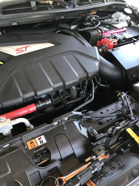

Fuel hose on my ethanol sensor stated to crack and weep fuel so it had to be replaced. My project Jeep is in the garage, so the wife's Jeep provided cover from the rain.
Got the line replaced no problem, but then the backside of the negative battery terminal nut/bolt stripped and the whole thing spins and I can't get it tight (or loosen it).
Found its part # CV2Z-10C679-C. Tasca lists it as unique to the turbo Fiestas (1.0 & 1.6) and the NA 1.6 uses a different one.
Am I stuck buying a new cable for $60?

I've had this issue myself. My friend and I just replaced the bolt on the cable and called it a day

The negative battery cable isn't just a cable. It has the battery management system built into it.
That's why I asked the question, to see if anyone found a cheaper alternative.
I'll give that a shot. It's on there finger tight and isn't in danger of coming off yet, just want to make it right before it gets worse.
