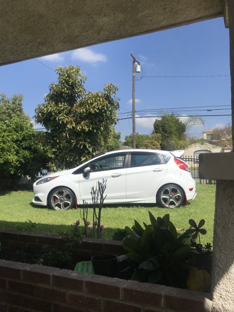

Cleaned her up for a photoshoot! Closing in on the 1 year mark in a couple of weeks [emoji4]
Looks SICK!! [twothumb]
About the only thing I don't love about those tires is that they are not XL rated, but being $50.00 EACH less than the XL rated Yok A052s in the 225/45-16 size, I may end up with them as well on either a second set of Dekagrams (in black this time), or a 16x8 set of gold or satin anthracite, Braid Fullrace As if I decide to go hog wild/for broke (they are more than 3 times each the price of the discounted Dekas [crazyeye][ohcrap] and about 3 pounds heavier as well). [:)]

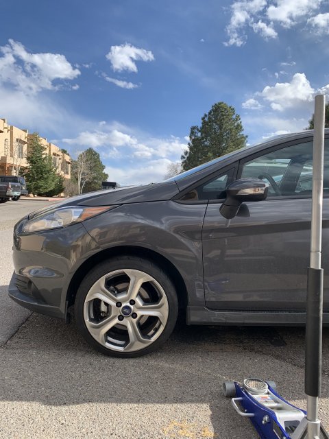

Tested out my new rhino ramps and swapped out my MTF with ravenol MTF-2 since I didn’t know when last owner did it. Oil fluid looked dirty, maybe some shavings but idk if it’s a cause for concern. 52K on the clock. Must say shifts are better and less clunkyness.

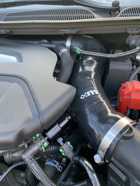

Went E30 (Dizzy) and drove around for 15 miles for the OAR to get to -1 (It was -.98 after 10 miles, which he recommends waiting for before you start blasting off, if switching from a different map.) I can't tell the difference, compared to my 93 tune, but then again I was in the suburbs where I couldn't do but one quick take off, and it was 50 degrees out on summer tires, so... Not exactly awesome grip.

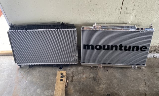

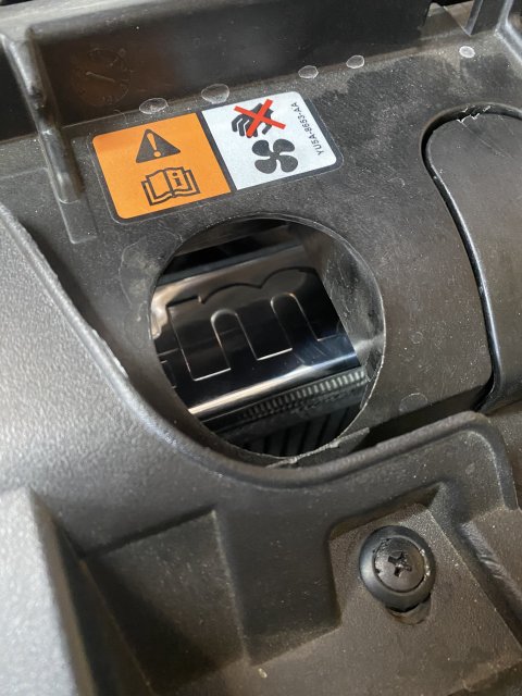

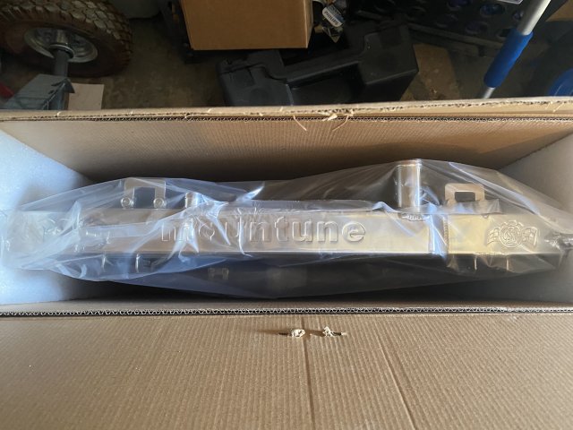

The bleed valve I ordered showed up early so I installed the Mountune radiator today. It took me a little over 3 hours. Not too bad just a lot of steps to complete. Hardest part was getting the fan shroud in and out. I lost one of the flaps on the side of the shroud. No idea where it went. Doesn't seem to be causing any problems.
The Mountune instructions aren't the best. I relied on YouTube videos to get things done correctly
I did run into trouble filling the radiator. I opened the bleed valve and filled the expansion tank. Progress was slow. It only took 1 gallon and would not take more without overfilling. Nothing was coming out of the bleed valve. Perplexed I started the car and let it warm up. No dice. So I took it for a drive and got it nice and warm. That seemed to do the trick. The expansion tank was nearly empty so I opened the bleed valve and refilled it. Coolant started to gush out the bleed valve. Closed that, filled the tank (it took another half gallon) and took another longer drive.
Its been cool out today, 65 degrees. I couldn't get the car over 194 degrees no matter how hard I beat on it. Most of the time it was in the 180-188 range. Brought it home and the expansion tank was right between low and full. So I think I'm good. I'll keep an eye on the levels.

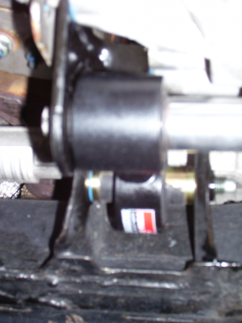

I took the risk of my Gestapo for the HOA neighbors telling the management company about me working on my car in my own driveway, and incurring a $150.00 fine, and finally installed the Vibra-technics 'fast road' RMM.
CRAPPY pic, but I could not get a good angle, or judge focus at that angle;
I did not actually drive it yet, but just judging from the startup, and moving the car from the driveway to the street parking space, I have to say that I am a bit disappointed (I even let it hit 122*F coolant temp to come off of open loop, and have that smoother closed loop idle).
It has fractionally/marginally less NVH than the CP-E it replaced, and it was done for the express reason of drastically reducing the said NVH of the CP-E unit. [:(]
Granted, it might 'break-in' a bit as everyone always says they do, especially rubber bushed ones like this.
I also did not put the car back up on the jack stands (it was LATE, and getting DARK when I finished) and loosen everything up and go topside and rock the whole engine back and forth by hand to 'settle it' as Vibra's instructions said to if it shows excessive NVH, but I really do wonder IF that could make any difference anyway.
I will leave it in for now, drive it some, and hope for the best, since I am getting way too old to be working upside down under a car for extended periods of time. [dunno]
Those of you with either your own small private lifts, or unlimited access to a lift just don't realize HOW lucky you are!! [wink]
While up on the stands already, I also swapped the 2 front exhaust hangers from the Cobbs to Whoosh's translucent blue ones just to see if that quelled some of the exhaust rattle I was getting when it was cold out, and did the spring oil change (Ravenol DXG 5W-30 with a Fram ULTRA (gold can) filter, and drained the Damond OCC (yielded about 2 ounces).
UPDATE; After driving around a bit, the reduction of NVH over the CP-E (and probably all of the high durometer poly RMMs as well) is more readily apparent, and actually noticeable.
Unless it somehow breaks, this item will stay on the car! [thumb]
