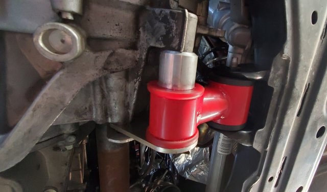

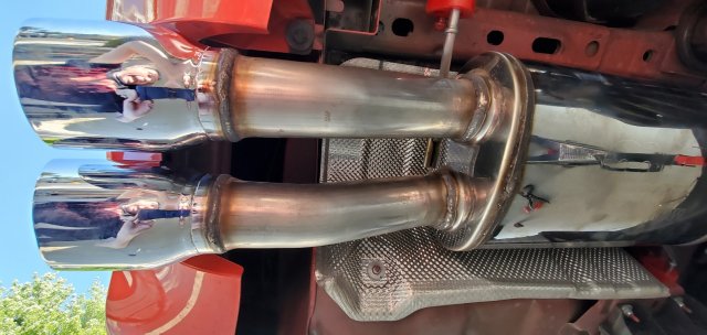

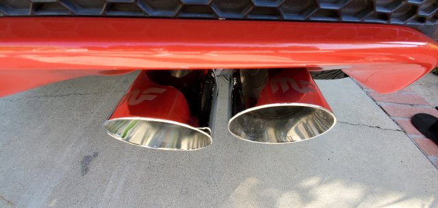

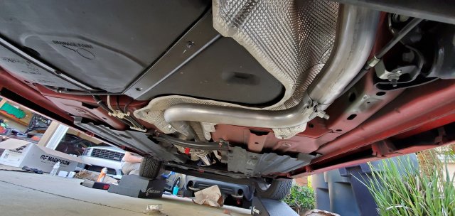

Installed, with generous help, ram air Big Mouth intake, AWR 88a rear motor mount, and MagnaFlow exhaust with PowerFlex hangers.
20190530_140153s.jpg 20190530_152351s.jpg 20190530_171625s.jpg 20190530_171633s.jpg 20190530_171651s.jpg 20190530_171704s.jpg
Yes, I do realize that the front hanger at the downpipe section was not attached in the photo and it's tacky....and I did see my reflection in the tailpipe tips in the next to last photo so I made a stupid face for S&G.
View attachment 20736 View attachment 20737 View attachment 20738 View attachment 20739 View attachment 20740 View attachment 20741
Definitely do a YouTube to hear the magnaflow !
