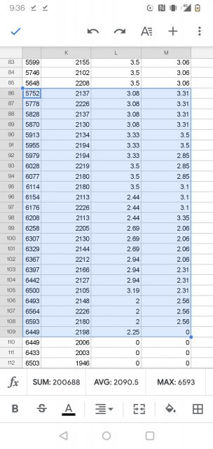

My tuner who many on this forum swear by and has a stellar reputation -
"we are seeing some corrections popping up already, which is quite strange for the amount of boost and timing we are running.
We should not really be seeing anything yet, so it makes me feel that either fuel quality or spark plugs are to blame
I've posted a screenshot of the datalog showing corrections.
my current plan is to dump a gallon of xylene into the tank and see what happens šŸ”„

Is the center right actual and far right desired timing?
