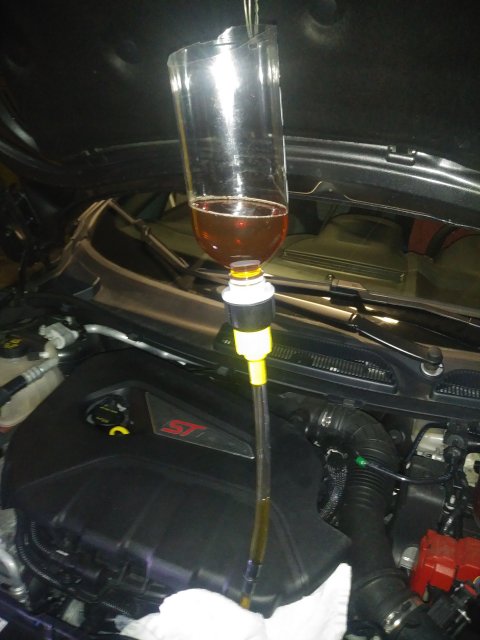

Ordered 2 bottles of ravenol mtf2 and a super long funnel
You do know that their bottles come with a nice little funnel/ tube built into the bottle to insert into the Fill hole correct? It's fantastic! Funnel shmunnel.....none need apply IMO.

Thread Starter #77
I forget which way the drain plug angles on the bottom. You could even drain it without ramps if you can get a drain pan to fit. It's quite an easy diy, iirc.
I'm going to order some ravenol tonight, probably swap it this weekend.
Then I have a dainty new beer bong woo
Lol nah with as much as my hand shake I’ll need all the help I can get. So the entirety of the two bottles and good to go - sounds easy enough.
Oh it is so easy....you don't even know Meng!
