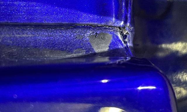

The roof panel meets the body side panel at that point. It isn't a solid weld line, there is body sealant under that strip. When replaced, they managed to peel away some of the body sealant, allowing water entry, the water ran down the inside of the body panel, and would come out where the panel meets just above the taillights and run then run into the car.
Was fun the track that down.

The drip rail trim is just a stick on piece. Gently warm to loosen adhesive to pull off cleanly.
The dealer apparently just yanked it off without heating it, as I could see three places where they pried it up. Thus pulling the body sealant with it.
Thankfully the parts aren't that bad. Expensive for what they are, but still tolerable.

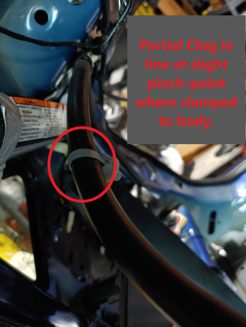

Update: (the short details)
This turned out to be Sun Roof related.

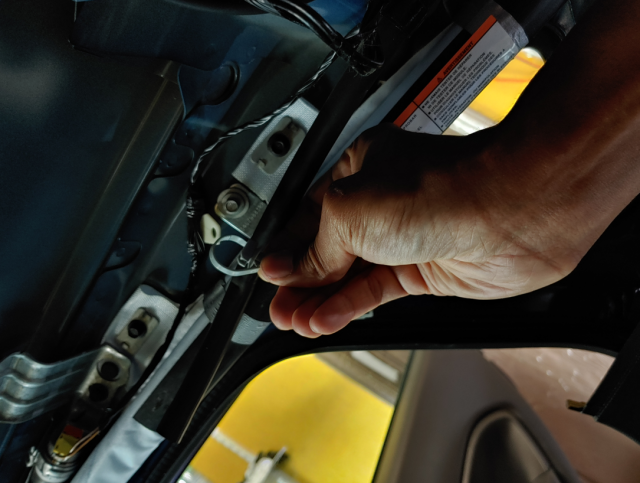

The rear passenger hose had a restriction due to partial clogging.
My cell phone bore cam (https://www.amazon.com/gp/product/B071HYRPND/) spotted the clog in the rear passenger line.
More details:
A smaller bore cam would've made it farther down the line.
There was a small water pool in the spare tire well. Never found water like that, back there before. The towels I had back there are why there wasn't more.
My earlier testing weeks ago, opening the sunroof and pouring a cup of water down the trough didn't really reproduce the issue.
Water would immediately and rapidly exit from behind the bumper. I only saw water leave the trough if I poured what I thought was an excess of it. So paid the test little mind.
I could only reproduce the issue if I spent literally ten minutes watering my closed up car as if it were a lawn, while it was parked in a specific angle.
I removed the clamp altogether and will wrap the line with layers of electrical tape to prevent abrasion damage.
The debris corresponded with the location of a clamp; the only visible clamp out of all the lines that was visibly pinching the hose.
It's a surprise because the pinch was very minor.
Blew out all four corners with compressed air; 150PSI using a blow-gun.
For additional measure, I used some pseudo-stiff telephone wire to snake-out all four lines.
Also ran a bunch of silicon lubricant down the lines. (will be pouring some lubricant in the trough from time-to-time)

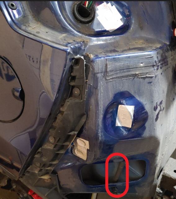

Where does the hose drain at?
164
169
Atlanta
#70
those exit behind the rear bumper cover in the quarter panel, the hose attached to plastic drains plugged into the sheet metal on each side.
The exit port is right below the vents behind the rear bumper on either side.
Oh that reminds me. On the driver side there was a tiny twig sitting at the bend in the exit on the driver side.
I fished that out with some needle-nose pliers back when I was taping and sealing off the grommet holes. (the clog was on the passenger side)
No clue how that stuff ended up in there since I don't leave my sunroof open and never open it with debris still on top of the car.
There did seem to be a thin layer of muddy build up... which I do know the source of. (parked under tree)
Did a little trimming; but technically it's still under the tree. (valuable as a sun shade among other things)
I know you say never park under trees lol...
I circled the line and exit port...
