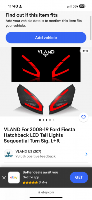

So I want to get taillights for my fiesta and I kinda don’t want to go with the generic spec d route. I saw these vlands that look nice and affordable but can not find anything on them ie videos or reviews. Does anybody know anything about these or have them? Are they any good? Do they require repining?

There's a guy on Reddit who has them and he likes them pretty well: https://www.reddit.com/r/FiestaST/comments/17uin4o View: https://www.reddit.com/r/FiestaST/comments/17uin4o/new_tail_light_writeup_video_link_in_description/
The brake, turn, and reverse lights are all very small and dim, so he ended up building a harness to make the whole thing light up under braking, solving one of those problems: https://www.reddit.com/r/FiestaST/comments/17yoe3g View: https://www.reddit.com/r/FiestaST/comments/17yoe3g/i_made_an_adapter_to_address_the_brightness/?share_id=LMfpDqNtxyyPuN_E-PKWj&utm_content=1&utm_medium=android_app&utm_name=androidcss&utm_source=share&utm_term=1
Ultimately as lighting is safety equipment, I would pass, even though they are kinda neat looking.

There are multiple posts on the FiST facebook page about them and of people who have them. I personally think the brake light is way too small and not bright enough to compensate for its size. I'll stick to my Osrams

I also just don't like the Spec-D's basically for the same reason as the Vland. Turn signal and brake lights are way to dim on the Spec-D's.
