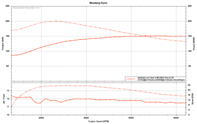

First logs on Dizzy 93. I couldn't run out 4th gear because I was running out of road, so I did 2 more 3rd gear pulls. I'm pretty happy with the numbers. I would like to be pushing a little more HP so I can hit redline on my logging road in 4th gear, but that will come with time. For some reason I can't see boost pressure or AFR.
All stock hardparts.
9.66 seconds 60-100mph.

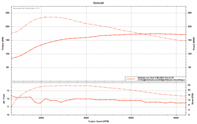

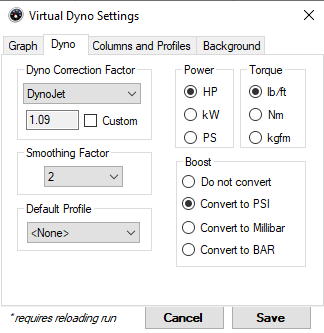

Use these settings under Options for comparison and getting the lower chart info to pop up...Keep in mind those column names must be exact...

Sure...but I prefer low average numbers.
But these are the ones everyone uses for discussion and comparison purposes and likely actually pretty accurate in general. If you think about it, do you really think you are really making only 150 at the wheels on a FWD that makes 197 at the crank and you are tuned? hehe... Anyway, definitely looks right for a stage 1 91 tune, looks good and healthy!
Edit: actually those still look low for a stage 1 Dizzy 93 tune, most of us are at 200/260...

It's a base tune. Literally the first map he gave me to start, they are usually very safe and conservative while they feel out the car.
I mean, it better be, I'd be pissed if he was going to call it done when I paid for a full e-tune for 93 and E30. I should have another 1 or 2 revisions coming to dial it in on 93, if he's anything like Freektune or Hypnotic. Then I move on to the E30 tune.

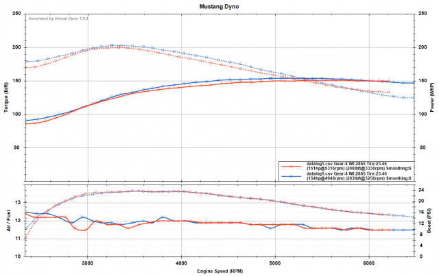

First 93 revision. Jason added timing, but the difference seems negligible. OAR's stayed negative through the pull.
1st logs 60-100 time was 9.66
2nd logs 60-100 was 9.37
Technically faster, but not by much, and nothing I'd notice day to day. Remember, I'm completely stock, down to the paper filter.

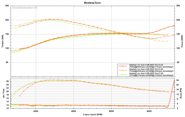

So after a revision adding timing, and this one adding a bit of boost in the mid range (I saw a max of 24.5psi), as you can see, not much of a difference besides a bit more torque. Red is today's log, Orange is the previous revision, and the Green is the flashtune. Jason isn't kidding when he says his flash tunes make about 95% of the stock turbo can make. Now, I'm not sure why the HP spikes towards the end, I actually end up going uphill towards the end of the road, but ignoring that, you can see the HP follows the same path as the previous 4th gear logs and following the points in time, I was making about 151whp towards redline.
60-100 times
1st log: 9.66
2nd log: 9.37
3rd log: 9.45
Today's logs were take about 7* hotter than my previous logs because they were during the day. It's still in the 90's here. It's hard to see the difference between the AFR's, but they've definitely smoothed out more and more with each revision now staying at about 12-11.9 throughout the run.
I think the 93 tune is done which is a relief because I will run E30 the majority of the time.
