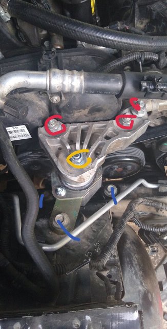

Remove the passengerside headlamp assembly in order to get at the motor mount nice and easy. Set aside somewhere safe so it doesnt get scratched or broken.
Now you can move the coolant reservoir out of the way paying close attention the the plastic line into the tank and not break it being a careless dingle berry.
This is where you can work smarter or not harder. I used my 1/2 cordless compact with a 15mm on the outside bolts and an 18mm on the engine side bolts. The top mount bolt is a 18 or 19mm. It will need to be removed as you will be using the aluminum mounting bracket with the new Motor mount.

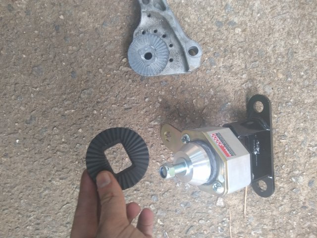

Now you will mount the aluminum bracket to your new Vibrtechnics mount you can buy from Ron a whoosh. Install is loosely and DO NOT tighten any bolts down until you have it in the car and all lined up. I also took this opportunity to put antiseize on the Bolts that go into the Frame to make things easier in the Future if there ever is one....AOC says there won't be anything left in 12 years....but I'm not chancing it and may have to take it apart again for some odd reason.
Once the mount is in Tighten the engine side bolts to 35 Ft.lbs and the Engine side bracket nuts to 59 Ft.lbs. Now you are good to go....reinstall the coolant tank....headlamp assembly and take a break and chill with a doggo or friend if you have any and maybe a beer or a nespresso. I chose to break with my Meatball and have a Nespresso...They are awesome machines.....if you dont have one and drink coffee....GET ONE. You will thank me later....Keurigs blow Donkey's compared to the Nespresso...FYI.

Here is the last of the mounts....this is the RMM with the 2 bolts and bolts with nuts. Depending on the RMM you may get a replacement bracket but with the Vibratechnics you will reuse your old mount bracket. You call loosen the top two nuts instead of removing them. But the bottom front and rear bolts will need to completely come out. Then after they are removed I used a pry bar to loosen/ wiggle the stock RMM. It will then just pull right out. Install your Vibratechnics RMM but make sure the alignment dowel in the mount lines up with the bracket hole at the bottom front bolt. All bolts will then be Torqued to 50Ft lbs. Now you have all your mounts installed.
