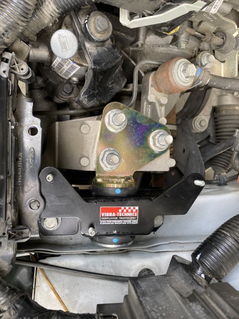

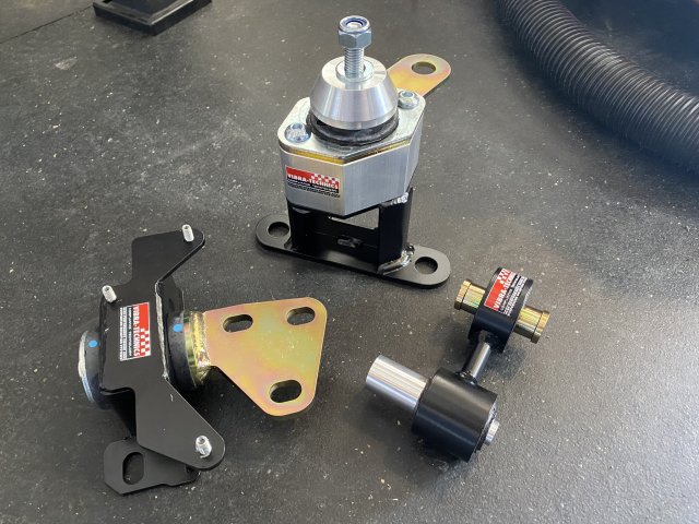

Decided to upgrade all three motor mounts and I'm wondering why I didn't do it sooner.
I went with the Vibra-Technics Fast Road set and install was a breeze. There is an awesome write up on the forums and it was easy to follow along.
Right off the bat, NVH was minimal. I have a 2018 model and I could only feel a slight increase in NVH from stock. Even if the NVH settles down over time, I was surprised at how tolerable and negligent the initial increase in NVH was.
The biggest improvements by far was shift feel and traction. Previously I had a COBB RMM with stock PMM/TMM and the driving feel is like night and day after install. Shifts are so much smoother and it also seems to put more power down without spinning the wheels.
Definitely a huge improvement over the stock mounts and I'd definitely recommend planning for these even if you're FBO. Shoutout to Ron @Whooshmotorsports for always being so communicative and shipping quickly.

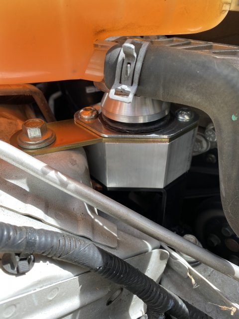

Just bought the engine motor mount. I have to pull the stock motor mount to replace the tensioner pulley so I figured I might as well upgrade while I'm in there. Will just upgrading one side cause any issues? I would do both but I'm broke lol. I already have a Cobb RMM, curious to see what kind of a difference the others make.
I'm not entirely sure but I would assume that replacing the PMM with a stiff one while keeping the TMM stock would lead to faster wear on the TMM and RMM. Probably not a big deal if you plan on getting an uprated TMM in the near future, perhaps another member can provide their insight on this.
Also, as you can see I went from a Cobb RMM to the Vibra-Technics and it seems to have helped a great deal. The Cobb wore out over time and got pretty soft. I've driven ~4,000 miles since I swapped in the Vibra-Technics mounts and it still drives like a dream. (y)

I have their RMM sitting in my garage. I'm surprised they don't add much NVH because I don't see a lot of bushing there. Must just be a good design.
Just wait until you run your AC at idle. It's the only time I get excessive NVH with all 3 mounts installed.

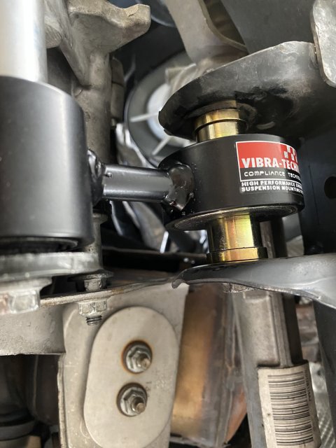

BTW everyone who has the Vibra technics RMM installed. Be sure to check it for tightness regularly. Mine has come loose a few times already. Thinking about adding a dab of loctite.
I think blue loctite is the temporary kind. Shouldn’t take much besides a dab.
