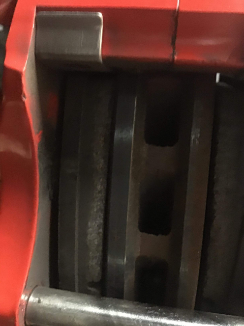

Okay, my tapered pad wear isn't just me. Are your pads tapered top to bottom or left to right? I.E. is your thin end of the wedge at the top of the caliper or the leading edge?
I did have my pads in the garage. After looking at them I'm still leaning towards trapped gases in the caliper due to overheating/boiling fluid which caused the uneven pressures and wear on the inside pad. Here are some pics of the pads. The wear isn't all that bad but definitely indicates an issue was present at the time.

My old pads look more like your passenger side, but I've forgotten which side was the leading edge. They taper in both left-right and top-bottom, which I didn't notice when I replaced them.

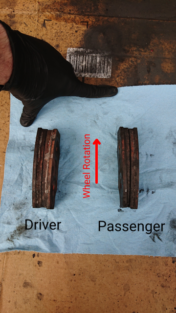

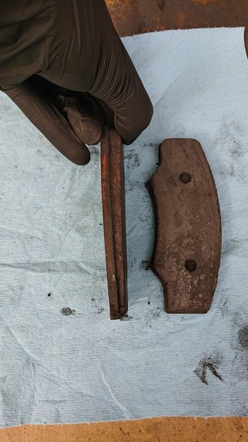

As promised, I took a picture of the pads after replacing them. My inside passenger pad had the worst taper, and the driver's side had very little. I guess despite my LSD, the torque vectoring is still more active than I'd like. I also stepped up the rear pad compound this afternoon, so hopefully that will help. The calipers are still leaking, though. They'll get rebuilt next week.
I'm switching to slicks (Spec Miata takeoffs I scored for cheap) for the next event, so I'll check the pads at the end of day when I swap to street wheels to drive to the hotel/home. I'll flip the pads while the wheel's off, since it won't take much more effort.
Just the inside passenger pad, highlighting the taper:

I have a set of these... not sure if this was mentioned but perhaps worth mentioning again if it was.
The calipers are designed with what's called a differential bore.
When installing... don't look at the bleeder position when assigning LH RH, but make sure that the "small" pistons are at the leading edge of the pad (top end) and the large pistons are at the trailing edge, as mine were delivered backwards (bleeders on wrong side but arrow decal correct). The offset bore is designed to reduce wear on the leading edge. Also refer to the part numbers as 03 is LH and 04 is RH.
I see that the OP had the same issue... and in all fairness the instructions do indicate to make sure bleeders are at the top, so that can be confusing, is the sticker correct or the installation of the bleeders and crossover. In my case the sticker was correct as this is where the smaller caliper piston is.
