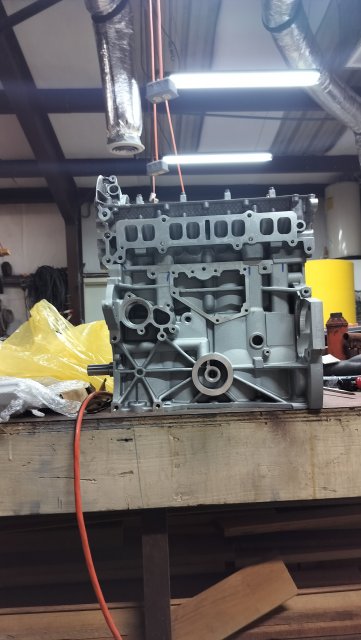

My updated 1.6 block arrived, haven't fully unboxed it yet this is the only photo I have for now
However i did do some digging from this picture it has thermostat housing design and coolant jackets designs from our mk7.5 engine, while having the cylinder walls from the 1.5 block

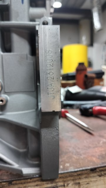

What is the block p/n? Should be stamped on the side, then we could scour the world for more of these mythical blocks.

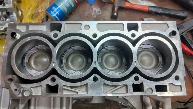

3rd picture is the part number for the updated block with the old style thermostat housing
