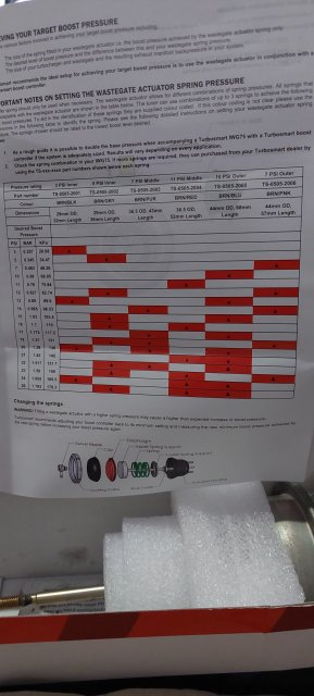

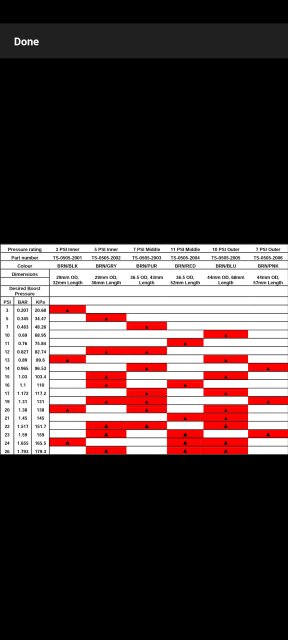

Just purchased a whoosh hybrid turbo. I already have a turbosmart iwg75 7psi so I opted out on adding the 14psi wastegate with the purchase. Does anyone know the specs on the 7psi spring like is it a middle or outer spring. Just needing know if I need a 7psi middle or outer spring to go with what I already have to make it 14psi. Also have a turbosmart em plumb back already. Anyone else running this bov with their hybrid. Just making sure I have everything ready when I install the turbo.

How much boost do you plan to run? You should run a spring that is half the amount of boost you are going to be pushing.

So should I get a 11psi spring then since whoosh hybrid turbo aren't suppose to exceed 26.5psi? I just want as much I can get. So that's why I was thinking 14psi.

Ask your tuner what they recommend.
