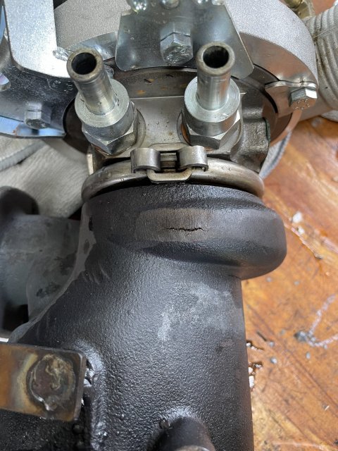

It apparently cracked at the mating flange and just fell off lol.
We had an interesting failure with the S280 on our track car. I'm not sure if I'm supposed to be posting about it, I can say the engine is ok, but the turbo... not so much lol
Love to know why you feel you can’t publicly post about it and glad you did. I had a X47 fail similarly and it was covered under warranty with no problems other than a long downtime. Did you have to pay to ship it to TT? Any issues with the warranty claim? How soon do you guys expect a replacement? Glad to hear the S280 is being used hard on track. Information like this is helpful to me since I’m in a position to upgrade to a bigger turbo. Thanks for posting the follow up too. The 2860 or G25 is looking better for my purposes.
Mostly just don't want to talk shit or seem like I am shit talking without knowing the specifics as to why the failure occurred.
We had bought a second S280 for our other daily driver in the house, so that is on its way and will be replacing this turbo. The daily will wait until we get this one back or we will just sell it and keep it stock turbo. We will have to pay the shipping to return the unit to TT, we have not been assured that any of the repairs necessary will be covered under any kind of implied or expressed warranty. I am not assuming that TT will cover this damage at all since it had a Tune+ spec WGA (I wonder who it was tuned by) attached at the time of failure and we do not intend to try and hide that fact. All TT has told us to do is send the unit back to them and after that we will move along with if it is warranty or not.
Understood. If you would, please let us know what happens in the end. Thank you.
