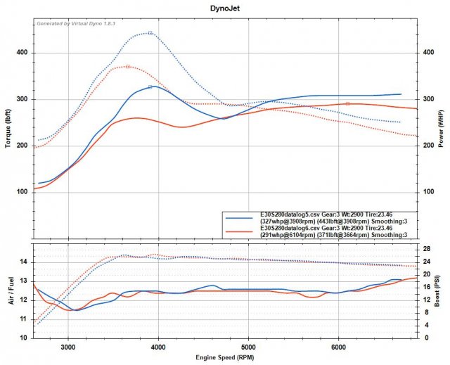

Huge thank you to @dhminer for putting these together! These are the last two logs I sent to my tuner. Anybody care to analyze these? I'm not very familiar with this stuff but these seem way off to me. bflan VDyno.jpg

Huge thank you to @dhminer for putting these together! These are the last two logs I sent to my tuner. Anybody care to analyze these? I'm not very familiar with this stuff but these seem way off to me. View attachment 42449
Those numbers are pretty crazy. Is your clutch slipping? Do you have fueling beyond stock? my highest numbers HP wise 310 and TQ wise was 340. I do not think you need to be disappointed lol.
Oh and ya I can nail it on a roll in third and spin tires and I know I am torturing my clutch.
Adam did not say anything about my pulls beyond the fact that basically I was at the limit of my fueling and needed injectors at least to tune it on E30 besides the basic E30 tune he gave me. I will probably wind up getting the injectors just to see 350 whp.
3rd gear WOT roll is why we all got this turbo though, no? Its my favorite part of the S280. Stock turbo compared to S280, it pulls like a freight train. Then gives you great mpg on HWY. Love it.
