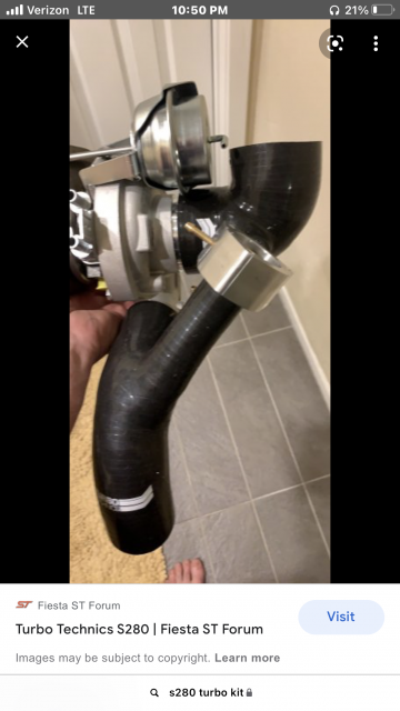

Question concerning bov coupler adapter:
has anyone had trouble with a small boost leak around the supplied silver casted coupler and your choice of BOV? Cause i do, and im considering using gasket sealer or rtv to seal it up to get a proper log for tuning….any suggestions or apprehension with my thought process?

Thats possible. I guess ill find out when i take it off to seal it up with some permatex gasket maker
Im guessing you have a turbosmart bov? get a new oring or put some permatex like you said, just be careful with it. You dont want permatex getting ingested into the intake somewhere.
