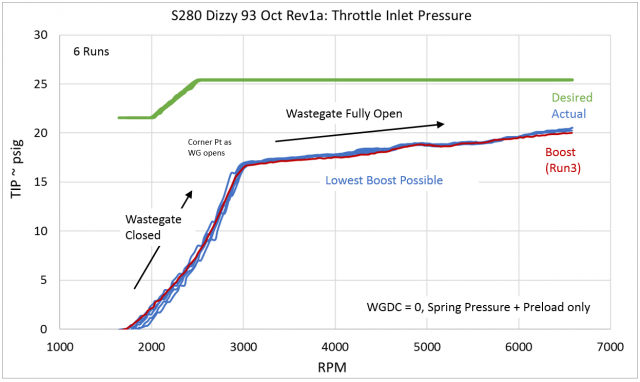

I plotted TIP since that is the target in the control logic in my case. I'm thinking the wastegate solenoid uses whatever the control logic is doing, but I'm not certain on that. I also wanted to show the target is well above actual, so it should not be affecting spool.
You know....I think I made a dumb post above since Im a FiST newb on the very specifics of the car. I believe the WG simply uses the boost pressure right at the turbo outlet on the S280. So the pressure there will be the highest in the system. If its say 20 psi at the turbo outlet it will be something less than that at the TIP and then even less than that at the MAP.

Yeah, thanks. Last night, I looked over the TS literature that came with the WG. It calls for 2mm. I checked the TT WG with a caliper, 3 turns that I used on the TS is 3mm, that makes sense as it's a M6X1.0. So, I'm at 3mm vs. recommended 2mm.
So, should expect WG to open a bit more than 14psi if the extra preload is considered. I'm thinking the corner pt on the plot is where the WG begins to open, but we don't know that for sure. 2-3 psi over 14psi seems like a lot for 1mm, but maybe the WG starts opening a bit sooner. I wish I had a way to check, just out of curiosity. Guess I'm just bored waiting on a tune update. :)

If you really want to make your life miserable in the pursuit of data and have the time to do so, you can just take a compressed air supply, connect it to the WGA nipple and slowly regulate the pressure up until you start to see the wastegate arm move....That would be the so-called cracking pressure.
This is obviously very easy to do before the wastegate is put on the car, a little bit harder afterwards, but shouldn't be too bad.

Yeah, thought of that last night. Doubt I'll do it now that it's on the car... it is what it is.
