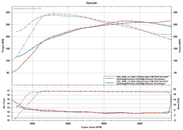

Looks very nice. Are you closing in on the limit of the stock fuel system?
I think there’s a bit more to go, probably 2 more revisions. Hopefully start tuning with aux fuel after Christmas if Mitch is in the office.

Are you gonna be using ethanol? Also when ur doing vdynos go back into your logs and delete the slots where you hit the Rev limiter to get a better picture. Alot of the times the drop-off in the power at the top end of the graph is from that.

Yes, starting with E50 and then eventually full E85

Yes - 4th gear logs = more load and better data actually.
Idk about that. They held okay while tuning E50 on the Garrett turbo. Will keep you posted once we get there.

I get that but most tuners ask for 3rd simply because of safety lol. The problem. With this turbo and my hybrid was just how early the boost comes on. Boost hitting at a lower speed equals more spinning but logging in 4th mitigates that.

Yeah i agree. Most of us are doing logs in third tho so it's hard to compare.

I've tested this out actually. Vdyno will read HP the same for 3rd and 4th. It's actually surprising. In a real world dyno there is a power difference.
I've also tested it and got different results. Your always gonna read higher in 4th as it's more load and it's the close gear to 1:1 in this car
