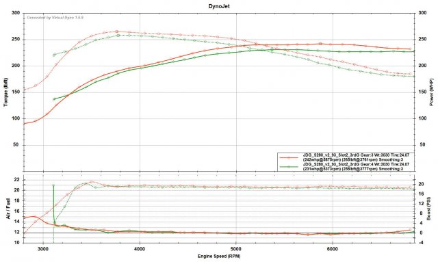

V2
Slightly slower spool noticed due to 60F charge temps versus 30F on previous revision.
