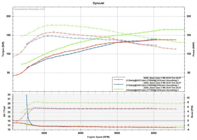

Base Tune Slot 1=Turbo Technics Wastegate Pressure (~5PSIG, decided to keep standard WGA as to not void the TT warranty)
Slot 2= 22% WGDC (~8PSIG)
Turbo warrentys are a joke and the stock wastegate is poo. Get a turbosmart and forget it. If you installed the turbo yourself it's already "voided".
I disagree. I literally did everything in Turbo Technics procedure to a "T" to keep the warranty intact. This includes getting a new oil feed line and priming the turbo until oil spills out of the return line (with it disconnected). This is coming from someone who has had issues with my previous 2 out of 2 turbos purchased for this car and the warranty saved me both times.
