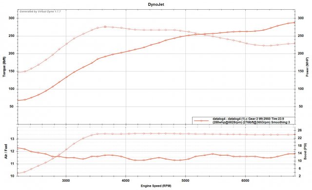

We're still in the safe zone, not really trying to explore outside of it. I am officially out of fuel on 93.
So this is the capability of the S280 on 93, without aux everyone! 270whp 300ftlb tq
Which makes complete sense. At least in my area it's just about the same on fueling with just about any turbo 270~whp is about it. The interesting numbers will be with better gas and aux.

I think on 93 you can definitely push it a bit further. Di cars like to run a bit leaner.
