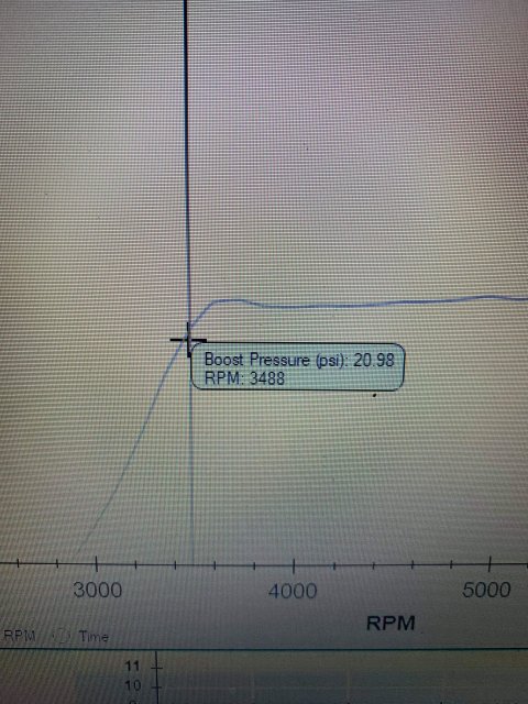

Well turbo install is finally done and on my base tune of 18psi its flowing more air then the stock turbo was on e30 and getting close to my hybrid on 93.
vdyno bro with all 3 comparisons lol
I'm in bed now ill see if I can get to it tomorrow. Vdyno said 240whp on 18psi but who cares vdyno is vdyno. Felt faster then stock turbo but without the donkey kick. No timing or boost ramping down low yet I was at like 20% wgdc.
Yeah that was my thought too. I’m making 16psi right now, and it feels loads faster than the stock turbo and has none of the kick. It’s nice and smooth.
dont really care about the hp numbers i am more interested on the actual graph
