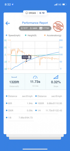

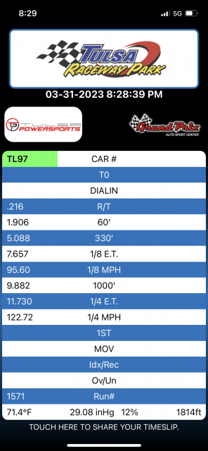

I need to get the video edited and posted, but we went 11.73 @ 122.7 this weekend! Still at 29.5psi boost. Saturday I installed the 3.5bar AEM map sensor, we are seeing around 33psi boost now. Adam said there are some changes he wants to make and we will have another revision before the next track outing, likely this Friday. This turbo is simply, bar none, the best.

It will be real interesting to see how she responds to a few more psi. I would assume, we will be flirting with CHOKE at some point sooner than later. This is the kind of excitement I missed having in the DSM world. Back a couple decades ago when people where probing the limits of stock frame MHI EvoIII 16g turbos.
