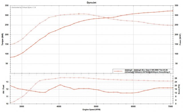

Also - I ordered the S280 kit recently, I will post vdyno results when possible.

From what I have seen on this thread is 335 whp the maximum power this turbo can achieve?
None of us have finished tuning. We are just sharing our progress. The upper threshold will likely be closer to 350-360 but again, just speculation at this point.

Where did you end up tuning to with your 2860 before you pulled it?
310WHP on 93 octane, 330WHP on E50 (but this was just one revision on ethanol). I got sick of it before I finished (lag, downpipe adapter coming loose, etc).

I sent my first datalog for 93+methanol injection last night. I will post results after the first revision, though I'm not expecting too much since I'm running 50/50 for now. I may run 80/20 (meth/water) mix in the future but we shall see.
