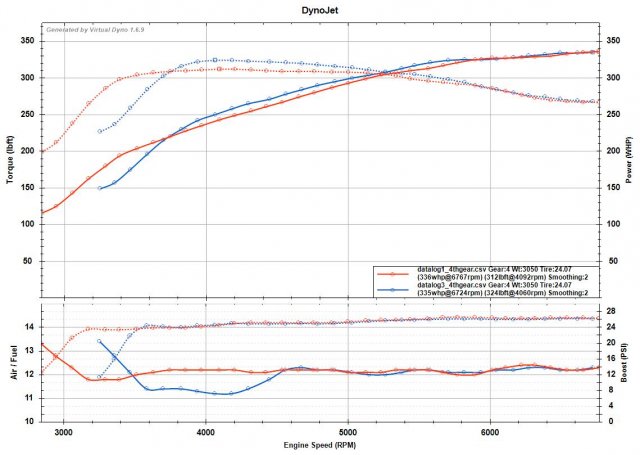

E75 v6 (Similar to the above just a bit more consistent). Ambient temps in the mid-60's today while previous logs were ~10F colder.
