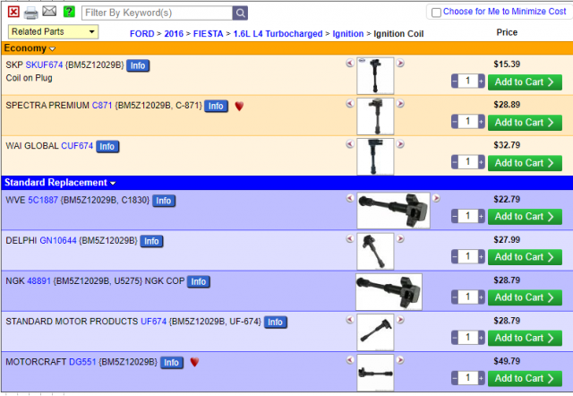

Was checking Amazon for replacement coils to use for troubleshooting but they all say for 1.6 Fiesta, don't mention turbo or ST. Are these the right coils or does the ST use a specific part? I may not actually need coils, so I don't want to go overboard on pricing. Anyone have recommendations for decent quality inexpensive coils to try?

Rock auto shows these:
Tasca shows this (oem/motorcraft), which should confirm the rockauto part numbers.

The Rock Auto NGK coils are pretty inexpensive, but I've heard of NGK counterfeits. Do we know for sure these are genuine? And as good as OE?

I've bought the ngk coils from rock auto and they are fine for me.

Rock Auto order placed. Set of NGK coils and 6509 plugs. Stratified says to gap them to .026". Have seen forum recommendations for .025". Don't expect the difference is significant...I'll call it a range.
