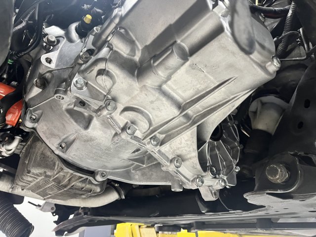

Picked up the new transmission and got it bolted in, post LSD and 4.3 final drive install. Now to put everything back together.
There was extra cost for the 4.3 based on the troubles @Fusion Works described. All in all, adding the 4.3 to the labor/parts cost of the LSD swap probably cost me another $1200ish …. I don’t know I would do it again.

Transmission install done. A couple test drives revealed no problems with it, though it’s tighter and slightly notchier than the old one. An adjustment to the Coolerworx helped that a bunch. Will report back after track work next month.

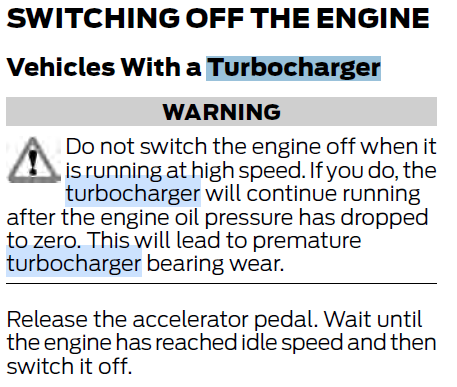

If there are no codes it may be intentional. There is an explicit warning against powering off without first letting the ECU return the engine to idle. I'm stock software/hardware and have only seen this after aborting a hard pull.

That warning has nothing to do with this specific problem. The warning refers to hard cutting the turbo and oil pressure going to the turbo bearings. 125K rpm without oil pressure will not end well for the bearings.
I disagree. You're interpreting this in absolutes. LOWERING the oil pressure at a time when turbo RPMs are high doesn't help the bearings.
A turbo doesn't need that much oil pressure, the galleys are tiny. Ford and common sense just doesn't want you shut the car down after running the turbo hard and potentially hurting the turbo bearings and not flooding oil through the housing to remove the heat. Rev hang was not done because Ford wanted oil pressure for the turbo.
Oil is also used for cooling and flow rate is an important component to that cooling.
