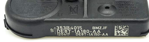

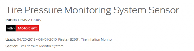

Most of the time I believe the DE8T-1A180-AA will trigger on 2017-2019 but is actually meant for 2014-2016.
2017-2019 is TPMS-12
9L3Z-1A189-A
if you go to parts.ford enter your vin and you can verify the correct part #
https://www.ebay.com/itm/264836078367
Man, I am not sure what to think, other than I know so far it doesn't work.
The Listing for the Sensors I bought give a Description of the
OEM: 9L3T-1A180-BB
CM5T-1A180-AA
9L3Z-1A189-A
DE8T-1A180-AA
TPMS-12
9L3T-1A180-AE
CM5T1A180AA
9L3Z1A189A
ZZDA37140
DE8T-1A150-AA
But they definitely say DE8T-1A180-AA on it
And you are right, the Ford Parts site claims - TPMS-12
