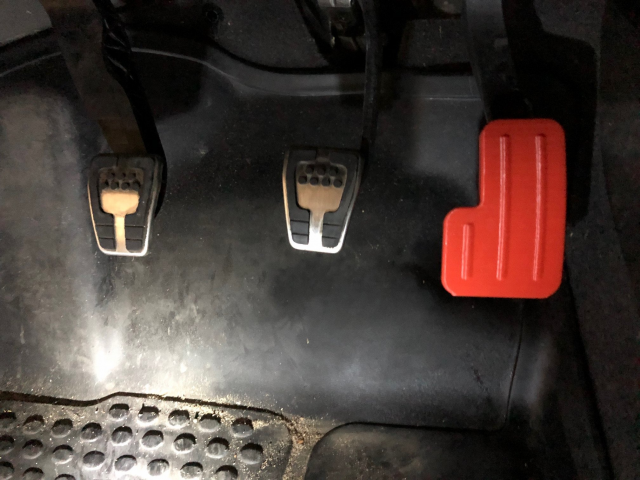

Works really well. Keeps the go fast pedal level with the anchor pedal!
I have a pedal spacer but even with my Razzter spacer and pedal cover it’s not 36mm that’s massive no matter how you look at it.:ROFLMAO: Oh and my pedal is about even with the brake pedal now. One would suspect that 36mm one would space the gas pedal above the brake which in my opinion would be an outright dangerous on gas situation and you have longer legs than I do.:ROFLMAO:

Hmmm - having the throttle and brake pedal at the same height seems odd. How do you heal-toe if the depressed brake pedal is lower than the throttle?

exactly my point about the 36mm pedal spacer. my throttle pedal sits just a bit below actually and the big thing is the pedal cover widened the pedal which was one of the big problems with the stock pedal not only being way to low but also being thin which spaced it farther from the brake pedal .

I’ve never thought heel toe was hard in this car with totally stock pedals. Y’all got me self conscious about my evidently fat feet now.
I do the half foot on the brake and ankle rotate or the ball on the brake and heel blip. I couldn’t make either work with my 9.5s until I moved the throttle over a bit and added pedal covers. My kid does a 45 degree arch on the brake and a toe blip with a stock setup.

Thats the Razzter it’s made by Forum member SirThomas88
We both have it. I also run his pedal spacer which is about as thick as the pedal combined they add 20mm in height of the pedal which is why I commented on the 36mm being massive.
First off, I rarely heel-and-toe in this car, anyway. I don't race it.
What I notice is that the brakes are touchy. There's a lot of initial bite in the stock setup. I often just braked hard enough that the heel-toe was awkward for me. I got too much brake to do it smoothly.
The Razzter setup makes it easier for me, but it's not perfect.
Ford Performance did a bang-up job making the FiST a really fun car to drive. I like it better than the FoST, which is also a great car, but rearranging the Fiesta pedals was just not in the budget.
I’m in the same boat - my feet aren’t huge (size 10) but for whatever reason, I can’t span the pedals to use the side of my foot and in order to use my heel to blip the gas, I have to rotate far enough that my heel hits the carpet on the side of the gas pedal.
I started looking into options to make the pedal closer, and realized that the reason the garage line spacer is so tall (30mm) is that any shorter and the original throttle pedal stud will interfere with the pedal assembly. It looks like the only way to go shorter and still shift the pedal is to shift ~1” closer, which puts the stud dead center on the pedal arm where there’s a gap, but it will require drilling a hole in the pedal assembly to clear the stud

I have a 7.5-8 size shoe and really struggle to heel toe in this car. I have to really twist my foot to do it and I end up pushing on the brake harder than I meant to.

I am still using the big spacer after all this time. I like how the pedal is still in line with the brake, for the rare occassion I heel toe the pedal is in a good spot.
