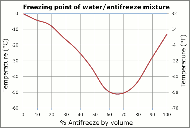

50/50 that shit....or if you wanna be Technical 68/32 but thats almost impossible without the measuring tools to be precise. Pour half antifreeze concentrate into a clean bottle and the fill up with Distilled water. I would dump the additive in first then fill it up and bleed the system of air. Also have a Antifreeze tester on hand to test the mix....it should read -34 which is a standard in Automotive service.

60% water and 40% coolant will net you approx -25F protection. no reason to use more coolant than necessary. the more water, the better heat transfer you will get.
Right now, according to the grossly inaccurate Prestone 'bulb' coolant tester thing (the one with the red arrow pointer in it), I am good to 0*F.
Does that translate to a 70% water, 30% coolant mixture according to the above chart, or am I reading it totally wrong? [dunno]
