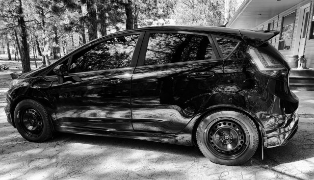

Got in the FiST today and it wouldn't start. Stero came on, door chime worked and the key fob locked and unlocked the doors but nothing when I pressed the ignition button. So I got the second key fob and it fired right up.
When I got to Lowes I changed the battery in the first key fob. Then got a notification on my stereo. Key fob battery low. At my next stop the notification was gone. Had I not been at home and able to get the second key fob I'd have been stuck. So now I have an extra battery and a small screwdriver in my car so I won't ever be stranded needing a new battery. Warning light after fresh battery installed, it doesn't get anymore ford than that. Hope this saves someone a headache.
