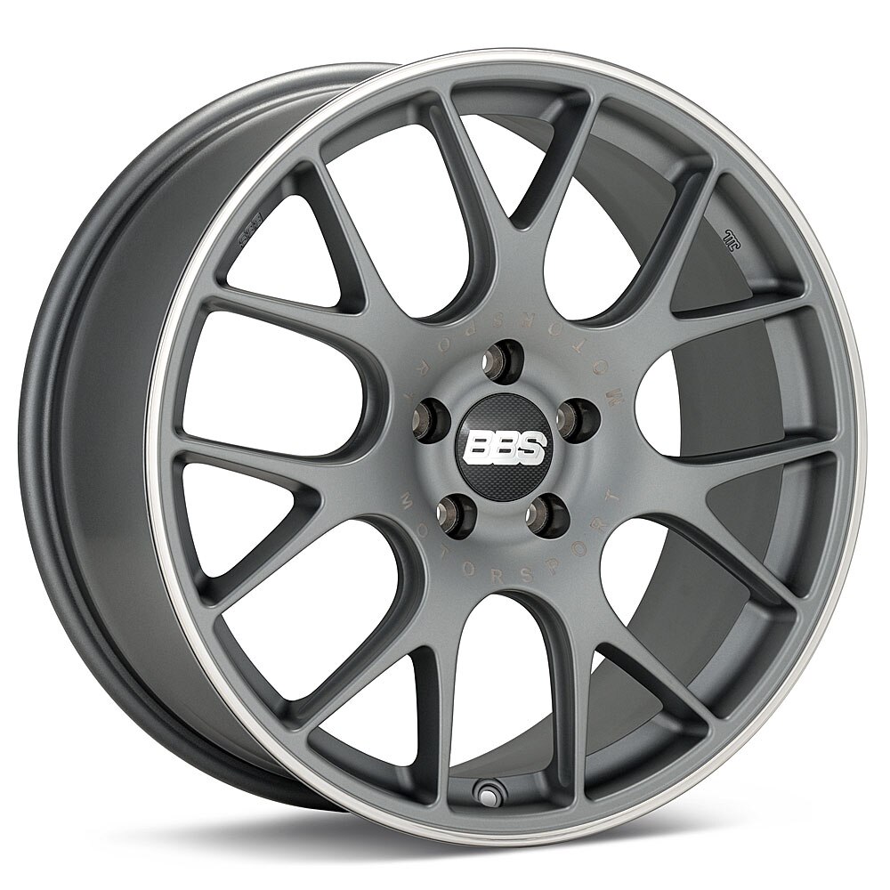

I really like those wheel...reminds me of these.
