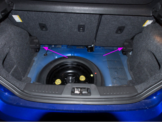

I've recently noticed I've been getting inconsistent thumps somewhere in the rear on bigger bumps and it sounded like its coming from inside. To my surprise, I found that both of the cargo floor perches were really loose. This is very strange because I'm 99% sure they were not touched since the car's purchase so they must've loosened up by themselves :unsure:? I snugged the screws back and that seemed to fix it (at least for now).
#12462
2,485
2,911
Mine loosened as well. I just assumed it’s because I’m too aggressive in my handling of the false floor.

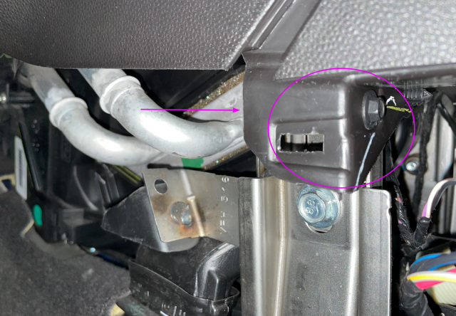

Centre console started making this annoying micro creaking when the car hit bumps on the road and I first found this video which pointed out the correct general location:
View: https://www.youtube.com/watch?v=x7TSTv5j91I
However, I didn't have a wooden block so I went one step further and found the exact part that made it creak and it's this bracket:
There's a clip inside where the arrow is pointing that does the actual creaking and it resonates all upwards the panelling like you wouldn't believe. Lightly spray into there with silicone lube and move it around to let it soak into the clip; that should take care of the creaking.
