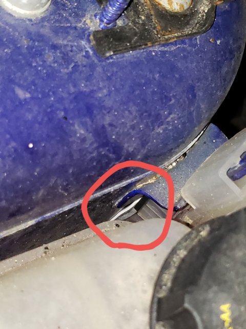

I solved a rattle today, actually, many percieved rattles. The last week or 2 my front right sounded like a bad sway bar link. 55k miles. Turned out to be the coolant overflow reservoir bouncing off the body. This rattle presented itself as 3 or 4 different rattles over different surfaces. Not sure why it suddenly got worse, besides the cold. Fix was a 3M taped rubber "shim". I hate ghetto fixes... but it's a daily, even in snow so... oh also the horn was rattling. That bracket is flimsy as f. 20191127_164018.jpg
