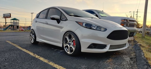

Got my 26mm spacers in from Motorsport-Tech. Will be using my stock wheels/tires for winter as I do not feel comfortable destroying my summers in the cold temps. I could've probably went with a 23mm to clear the BBK. But I'm happy, looks alot better in person too. It probably has 1/8" of poke at most, that I can deal with for a few months out of the year.

I didn't think it was even possible to clear the BBK with stock wheels. Good to know.
Yeah it is, just need like a ~23mm spacer. I got a 26mm to be safe and have good room. I have enough room to go down a few mm's but I saw what a FiST with stock wheel and a 25mm looked like and it makes the stock wheel look much better.
With a 26mm it pokes a little but VERY little. I'll only need to deal with it for a few months for winter so it'll be good.
I think I may be the first to use stock wheels with the Stoptech BBK..

That's about as 'flush' as I've ever seen a factory wheel setup. [thumb]
Yeah, I'd honestly say it probably has about 1/16" of poke but nothing major. Nothing that I can't deal with for 3-4ish months out of the year. Everyday I like it more and more.

Are those stock size tires on your stock wheels with the spacers and no rubbing any where? This what I'm looking to do on mine. Thanks.
Yeah, stock 205/40/17 Michelin Pilot Sport A/S 3s. Only rubs on very hard severe bumps. Easily avoidable.
