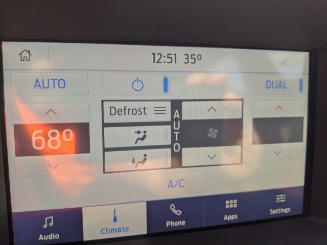

So I ran the update (non NAV) with no hiccups this morning and just replaced the hub, and I now have USB fast charging on my Pixel! I also think the 3.4 interface looks a lot cleaner than the old one.
It also kept all my Forscan changes through the update (boot logo, Sirius delete). It also finally enabled climate control on screen. I had turned everything on in Forscan years ago but for some reason it never worked, and now it does.

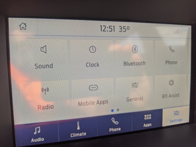

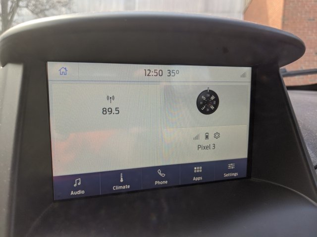

Does anyone have pictures of the new UI running on the fiesta screen?
I'll take some later today.
