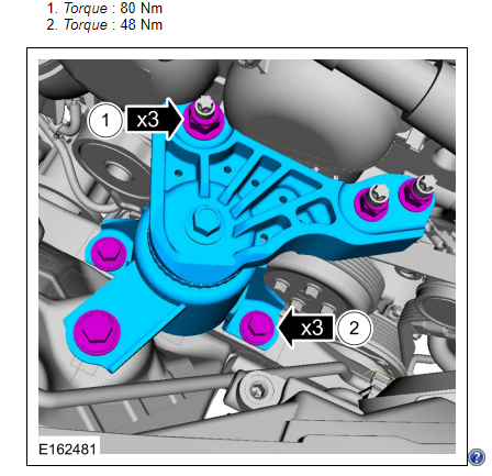

From searching I've seen I'm not the only one with this issue. However, all the threads I've seen are several years old and inconclusive. I've removed the drop links to the sway bar to no avail. I've checked the passenger motor mount bolt and it's fine (no sheared). I can't detect any play in the lower control arms and unfortunately can't visually inspect the puck bushing for damage due to the design as it's hidden. I've pried around under there and can't find the culprit. Any new revelations in the past couple years as to the cause?
Could it be a worn passenger motor mount? I have a fairly new transmission mount. Just saw this video after posting:
View: https://www.youtube.com/watch?v=TruQTIl-UDg&ab_channel=HappyHill%27sCars%26StuffHappyHill%27sCars%26Stuff
