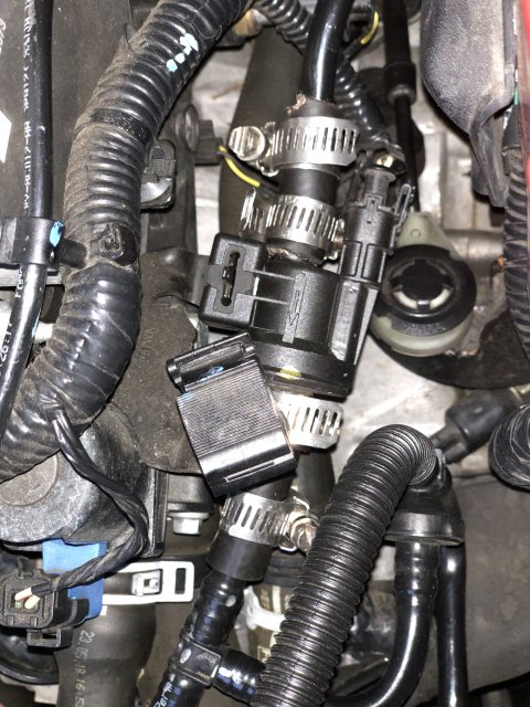

I had actually replaced mines with the 2014 tube “upgrade” but the evap purge sensor ended up going bad in that one in less then a year? Went to my original 2 tube system to test as had initially thought it was my evap canister which took a hit a month or so prior with some road debris…
Crap location to have that cannister but meh.
The purge sensors fairly inexpensive themselves and just ended up doing what this member did. Just cut around it, used fuel lines and clamps and makes for an easy swap when the issue comes back so keep a couple of spares purge sensors in the car. Did the surgery last year and so far so good, though, I do leave the gas nozzle in for 2-4 minutes after it stops pumping which signals me to routinely take time clean windows and spot check fluids.

It’s ironic, my original two line on a 2019 actually never failed. I bought the 2014-2015 single line new as a preventive measure and that failed in less than a year. Decide to replace the sensor as pictured.
Bought a handful of the sensors, keeping a couple in the car.
