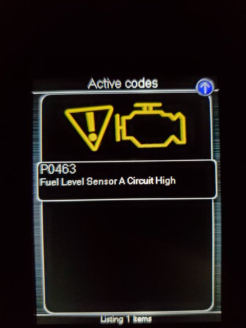

Hey, I wanted to chime in. I ran into the same issue today, I actually have a check engine code to go along with it. I haven't had time to dig into it yet but I'll attach this for anyone else having issues.
