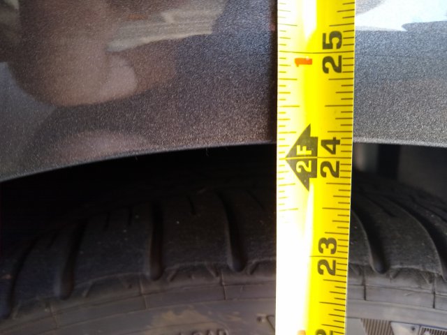

Just took mine yesterday in expectation of maybe one day getting my Swift Springs I ordered. My garage is fairly level but the ground is blacktop so its not nice perfectly smooth concrete, but measurements should be good. I have Rota Titan wheels but they are 17" and the original OEM tires on them.
Driver F: 24.5"
Passenger F: 24.75"
Passenger R: 24.8125"
Driver R: 24.75"

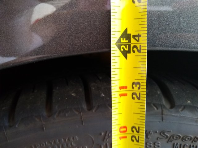

Ok, got enough time and miles on the springs to consider them fully settled.
With swift springs and stock, 8900 mile dampers:
driver front: 23.5
passenger front: 23.75
passenger rear: 24
driver rear: 23.9375
This gave me exactly 1” in front and .8125” in the rear.
I measured with a small piece of bicycle spoke up uner the fender sticking straight out to ensure I got a vertical measurement from the ground to the top of the fender. I also didn’t look back at the before measurements when I took the after so as not too introduce bias in my reading of the numbers.
