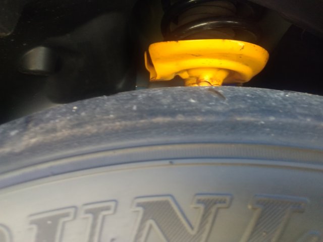

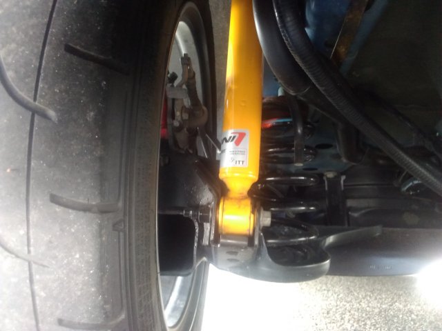

I am running stock coils and Koni Sport dampers all four corners. Harshness is greatly reduced without ruining the handling. Plus, the Koni Sport is a rebuildable item! Our dampers are far more likely to be damaged by a pothole impact than by normal wear and tear. IMG_20190926_133250.jpg IMG_20190926_133224.jpg
