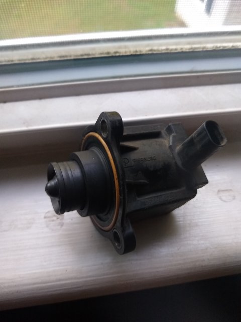

It feels like a dense plastic to me. The internals also feel cheap to me if that makes sense, especially compared to the turbo smart bov, which is definitely better quality than the stock one. IMG_20220807_075711335.jpg

There’s definitely been examples on here of the stock BPV leaking.
only other thing I would think of, would be if one of your boost hoses are coming off
